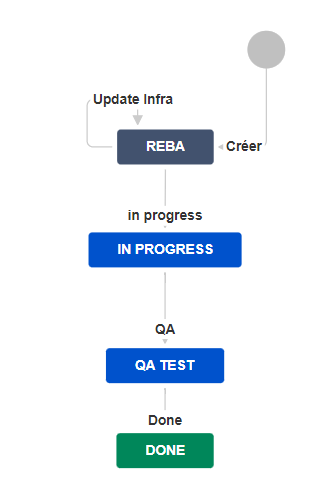

Below is Subtask Workflow
Sub-task : Workflow :
There  is  custom field,  “Infra” in the subtask.
  • When status is in “REBA” the custom field “Infra”  should be  Read and Write  (Also if and if the parent issue type is “Informat”
  • When status is in “In Progress” the custom field “Infra”  should be  Read Only  (Also if and if the parent issue type is “Informat”

For the read and write Infra field, i guess to add it only to view screen and then add a new transition from "REBA" to "REBA" like the attachment below. On the "Update Infra" you can add a transition screen that contains "Infra" field.
Finally, you can add a scriptrunner "Simple scripted condition" with this code to let the transition visible only if the parent issue type is “Informat”.
return issue.getParentObject().getIssueType().getName() == 'Informat'
I hope it could help you.
