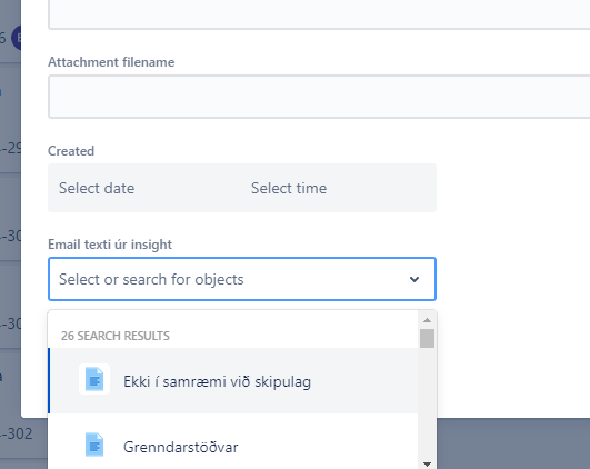

Yes I managed to get that automation working.
The issue is using hardcoded data or data from insight
here you can see an insight asset linked and I select the text from that dropdown list, this seems to be working ok.
But how do I pull the selection data from this ?
I know the field is called "Email texti úr insight" I also know there is a field called Maintext that contains the text I want to use , so I somehow need to get the selected item from insight and put that in my maintext, how can I refer to it ? {{something?}}
