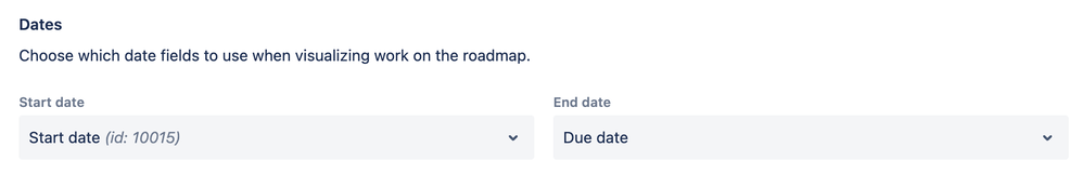

Note that you can specify in each advanced roadmaps plan which date fields you would like to use as start en end dates for the roadmap. You can do so in Plan settings > Scheduling:
Screenshot 2023-04-26 at 19.51.25.png The other way around, if you would like to use due date instead of end date on your Jira issues, you would have to replace that field on all screens where it occurs.

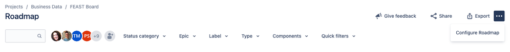

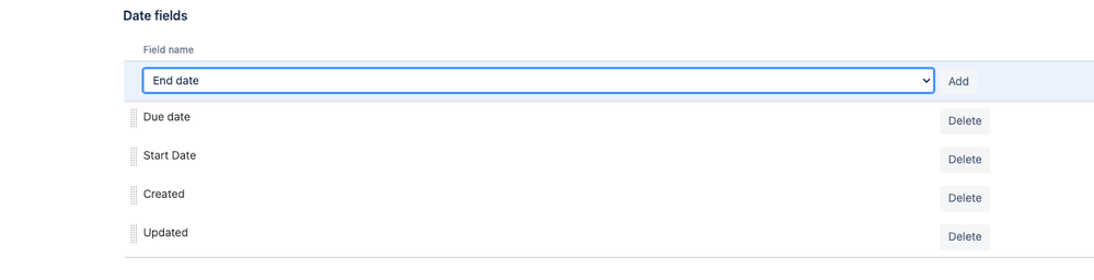

@Walter Buggenhout thanks for your reply! In the roadmap settings, I don't have Plan settings > scheduling - instead via the ellipsis there is "configure roadmap"  Screenshot 2023-04-26 at 2.49.34 PM.png from there is an "issue detail view" setting showing the general fields. Once there, it appears that via the Date fields section, I can add the end date field that I'm using in the issue screens associated with this project. What I'm concerned with is - what to do with that Due date field in the roadmap config? Is it "safe" to delete it and add the end date field instead - if due date is a system field? What would be the impacts of this action and is it reversible?Screenshot 2023-04-26 at 1.26.57 PM.png

That is not the advanced roadmap@Barbara Shaw Advanced roadmaps belong to the premium plan of Jira Software and are accessible via the Plans menu. Once in a plan, you find Plan settings under the ... button, next to the plan title:
Barbara Shaw
April 26, 2023
🙈ugh. my bad. We have adv roadmaps capability but this particular roadmap is not an advanced roadmap

@Benjamin I was able to add the system field "Due date" via the issue layout and then add the due date field to my screens
