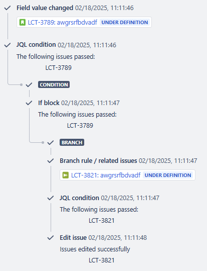

Results with an empty Fix version field when adding a version
Result with a version already in the Fix version field when adding a new version

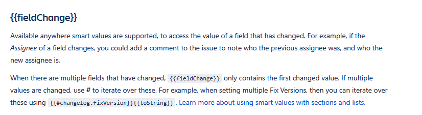

From documentation, looks like below may not work for list of fixVersions
{{fieldChange.fromString}}

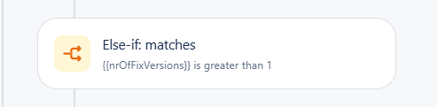

If {{nrOfFixVersions}} = 1
Else-if {{nrOfFixVersions}} is greater than 1
If the Fix version field is empty and I add one version nothing happens, If {{nrOfFixVersions}} = 1 doesn't catch it. Though I print the variable after creating it and it reads 1.
Continuing and adding a second version, the Else-if branch catches it and creates a new Sub-task with the second version (correct behavior).

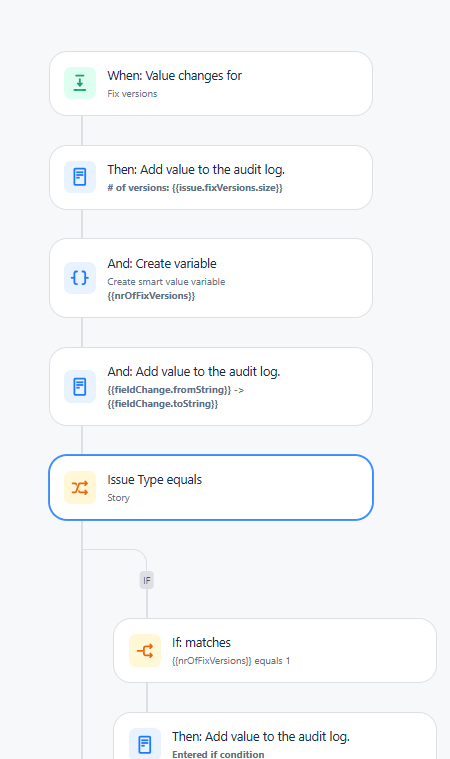

Can you create the variable before the if block
When i try like this, it is entering the if block when first fixVersion is added
Martin Karlsson
February 19, 2025
Still doesn't work.

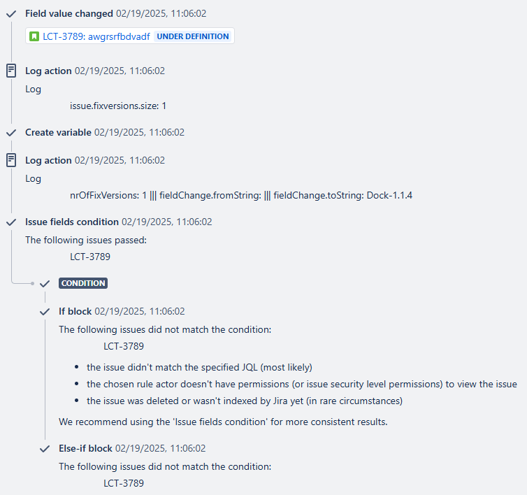

I again ran my automation my audit log shows match when 1st fixVersion is added.
There seems to be a case mismatch in fixversions. Can you use fixVersions and try with that?
Additionally, do below
when creating smart Variable, in smart Value, put like this
{{#debug}}{{issue.fixVersions.size}}{{/}}
It will print the value assigned to nrOfFixVersions in audit log. there is a case
And in if matches, use
{{nrOfFixVersions.asNumber}}
Let's see how it goes.

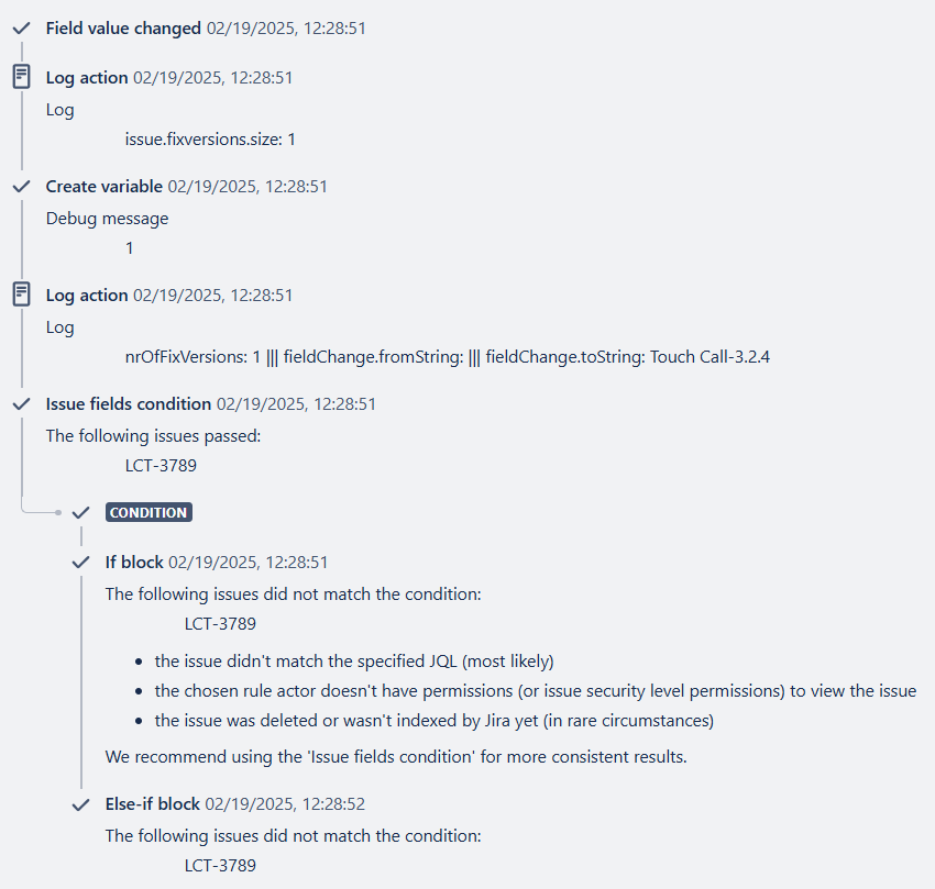

Martin Karlsson
February 19, 2025
What do you mean by mismatch in fixversions? Not sure what you want me to try here, but with
and
I e If: matches{{nrOfFixVersions.asNumber}} = 1
Correct?

For Jira Cloud, there are long-standing defects / inaccuracies with the changelog for list fields (e.g., Fix Versions, Affects Versions, and Sprints) which is available to automation rules.  These symptoms can clearly be demonstrated using the built-in smart values that should specifically show the added / deleted values but do not: https://support.atlassian.com/cloud-automation/docs/jira-smart-values-issues/#--fieldChange--
