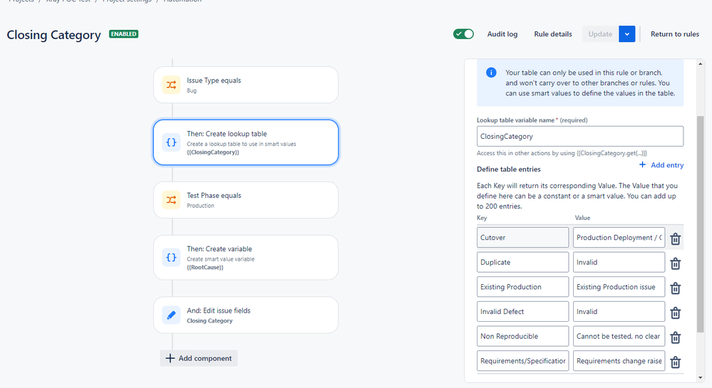

I think I've done step 2. And am now looking at step 3. But unsure what to do for the key and value table entries.
Vishal Biyani
February 7, 2025
Variables need to be without spaces i.e. one word. So it should be ClosingCategory
in key enter enter Cutover and in value add Production Deployment / Cutover Issue
then click on + Add Entry to add remianing 5 values
Key Value
Cutover Production Deployment / Cutover Issue
Duplicate Invalid
Existing Production Existing Production issue
Invalid Defect Invalid
Non Reproducible Cannot be tested, no clear recreation, speculative fix
Requirements/Specification Requirements change raised in pilot or rollout}

Screenshot 2025-02-11 081649.png This is the table set-up. Is this not correct?
Vishal Biyani
February 11, 2025
Table is fine. Check and share what you have in RootCause? it should be using the lookup table
