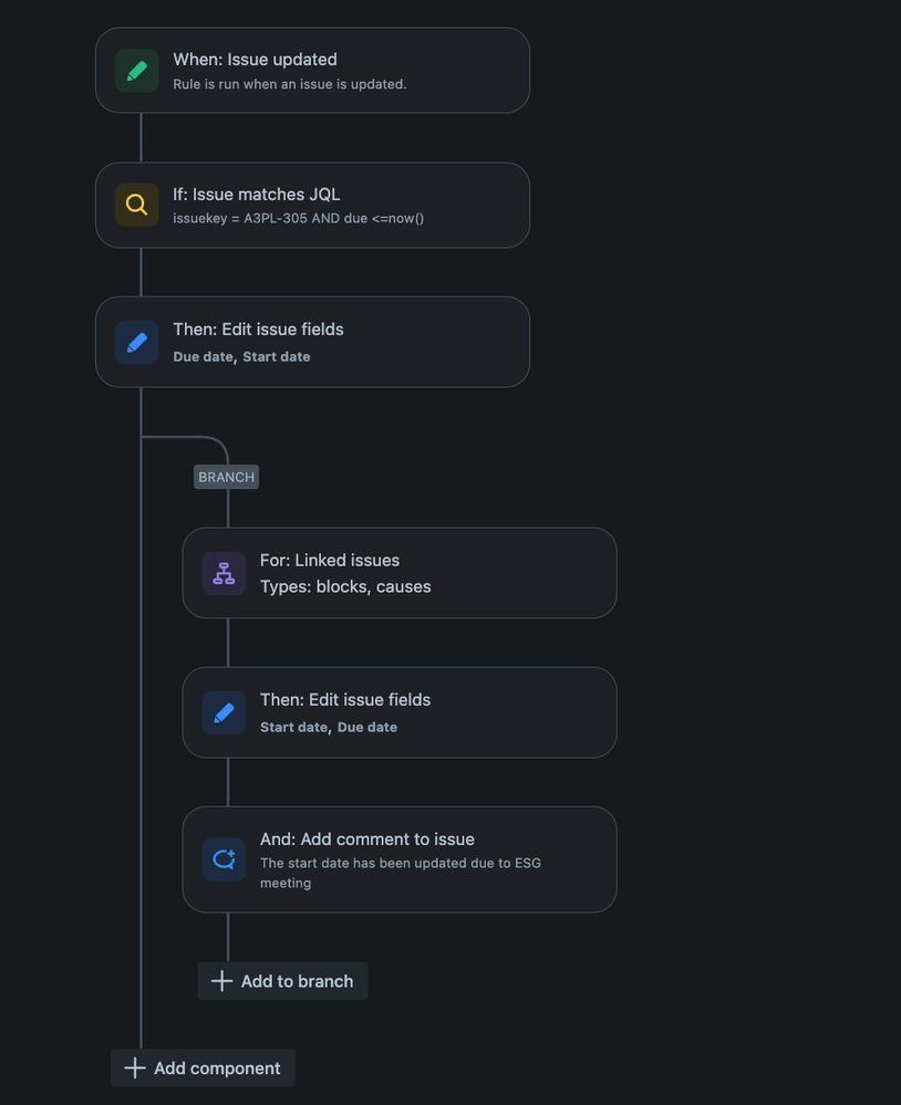

I am trying to build an automation that will automatically update the start and due dates of linked issues from the trigger ticket.
So far I have the linked issues updating fine but the linked issues have subtasks and i would also want their dates to be updated at the same time. I have tried many things, but cant get it to work. Does anyone have an idea on how I could do this?
Current setup of rule:

Next, the rule image you show is triggered on Issue Updated, and so that will run for all changes. Is that what you wanted? If instead you want the rule to only run when the Start Date or Due Date change, consider changing the trigger to check for changes to only those fields.
Next, when trying to update multiple issue levels / links, normally that cannot be easily done with one rule. And when a second rule is used (just to update the subtasks) that could lead to runaway rule triggering for unrelated issues because this option must be enabled: "Check to allow other rule actions to trigger this rule..."

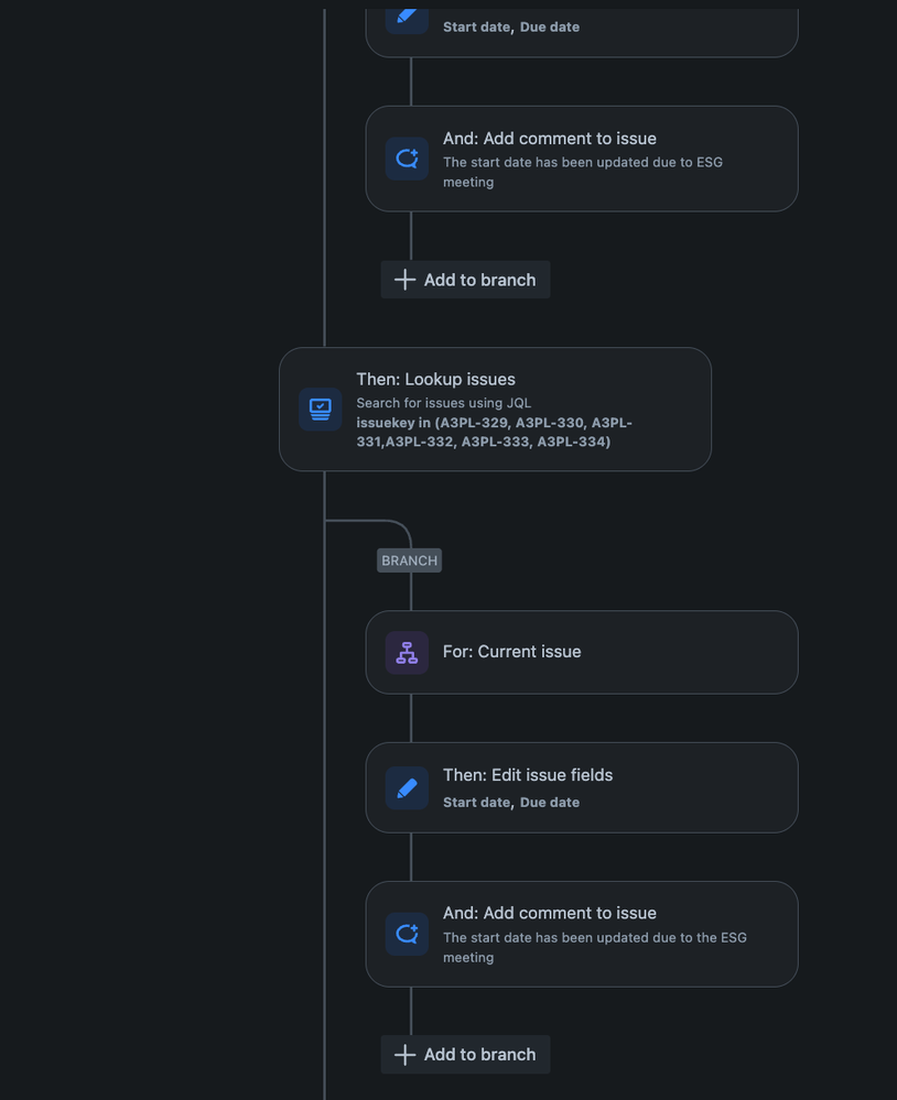

If you are setting all of the Start Dates to the same value (and the same thing for the Due Dates), one possible workaround to prevent problems is:
This approach will only work when there are 100 issues or less to update.

Im doing this as I have a go/no go task (A3PL-305) that if we say "no go" the next time we will review will be the following week, so the idea is that this rule will run on a schedule and if the due date is elapsed it will auto move the ticket to the next 7 days, and by doing this it will update all the corresponding linked tickets (and hopefully subtasks of the linked tickets) to add 7 days to their Start date and Due Date.
I was thinking of having another rule setup that is hard coded to the linked tickets and when they are updated it has a branch to update the subtasks as well but couldn't get that to work.
Open to other ideas to make this happen
I recommend against hardcoding as that could lead to maintenance and other errors.
Please try that last approach I suggested as it will allow the updates to happen within one rule, reducing the chance of errors.
No; my suggestion was to use Lookup Issues and JQL in place of the original branch on linked issues. With that result, their subtasks may be found for each issue. Then combine those key lists into a single list of keys which may be searched with a JQL branch to finally update the date fields.
