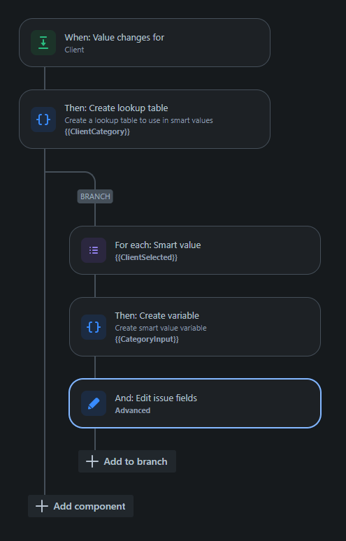

Hi
I am testing an automation that populates categories (a multiselect list) field based on input in another multiselect list.
The automation includes a lookup table to determine the categories to apply with the last step adding values to the category field using the following advanced edit:
{ "update": {
"customfield_12345": [{
"add": {
"value": "{{CategoryInput}}"
The rule runs successfully however the edit step replaces all values in the custom field rather than append the list.
I assume this is due to how I have written the advanced edit.
Can someone offer some guidance please?
Screenshot of automation flow below:
October 23, 2024
Hi @Sean C-S -- Welcome to the Atlassian Community!
To clarify your scenario a bit, are you trying to copy values from one multiple-selection option field to another multiple-selection option field, perhaps translating the values in the process?
If so, your rule cannot use a branch to do so.  The reason is branches which could be on more than one thing are run in parallel and asynchronously.  And thus each pass through the loop will "walk over" the prior results, but in no particular ordering.
Instead you could use list iteration to pre-build the JSON needed in Create Variable, and then perform a single Edit Issue action with that variable.

Hey @Sean C-S , welcome to the Atlassian Community.
In the Edit request you will need to include the existing field value as well as the new value you want to add in the multiselect for it to be added and not replace the existing value.
Let me know if that works and I can support you to troubleshoot the automation.
Sean C-S October 23, 2024 edited
Hi @Marios Marneros
Thanks for answering.
I'm not sure how I can achieve that in the branch since 1 - n values could be added.
Do i need to create a list (array I think) of all the values that are added and then add it in bulk maybe?
Sean
