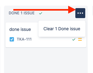

3. You could use the Clear Done option that is available in the Done column.
