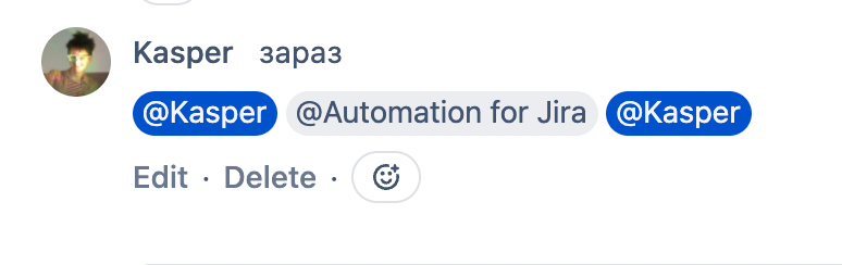

My automation works well and as i want but i can't tag that persons who are diplayed by automation.
Here how it looks like now:

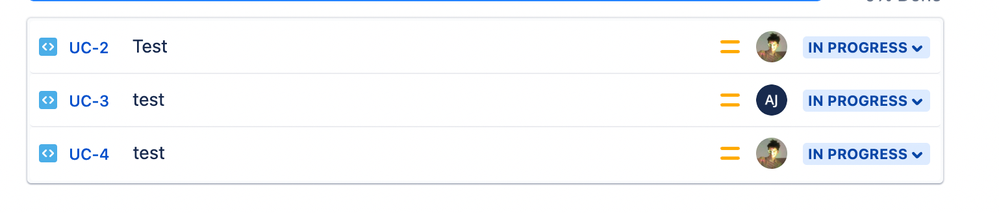

Here the list of sub-tasks as you can see it's works.

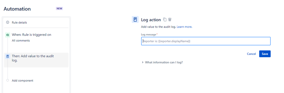

Hi @Casper , you could also test this by logging the smart value in the audit log, like this -
if you prefer to do this instead of inserting the comments in the issue for real. In this way, you can test the code / smart values by running the rule and then checking the audit log for the rule, the results of the smart value.
Just a suggestion. I hope you get it working how you want.
