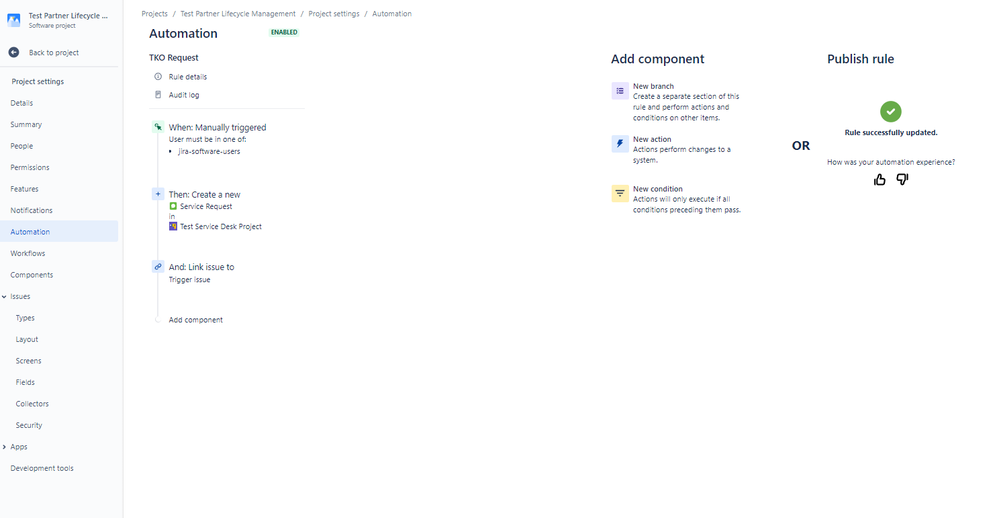

Hi there - looking for some guidance on how to set up a multi-step automation rule for a couple different scenarios in Jira Cloud. I tried to follow the automation guidelines in the Atlassian documentation but I can't seem to make it work.
1. When a ticket is created in a software project, upon manual trigger, a new ticket will be created in a service project AND the 2 tickets will be linked together using the "relates to" link type. (I have attached the 2 different ways I tried to accomplish this as screenshots)

Thanks for replying. I thought my first screenshot, without the branch, should accomplish what I wanted too. However, it doesn't seem to do anything when the rule is run :(

Can you please show the details of your rule's edit and link components, and and image of the audit log details showing what happens when the rule runs?
I know that "clone" cannot link issues in one automation step, but I thought the Issue Create action could do so.  Perhaps this rule also needs multi-project scope.

The log says the rule runs successfully, and it does indeed create the new ticket - it just ignores the Link part.
Kyra Mayock April 26, 2022
I actually think I figured it out - I had to add the action of create rule, then create a branch and select "most recently created" then add the action of Link Issue!

Well done!  That is what I thought was happening with the missing branch to the created issue.
