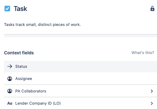

The issue type layout for Team 2

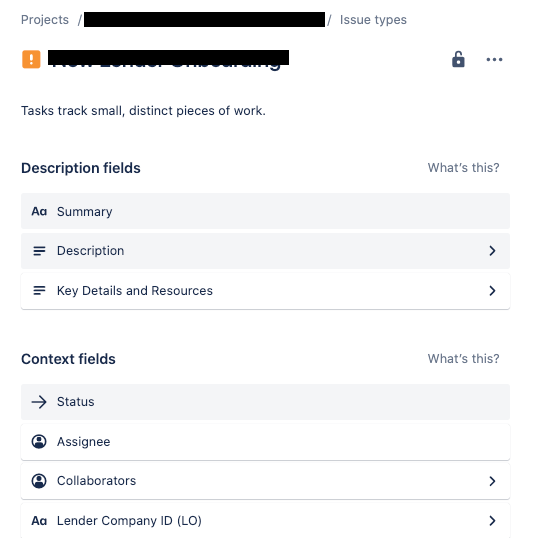

The issue type layout for Team 1

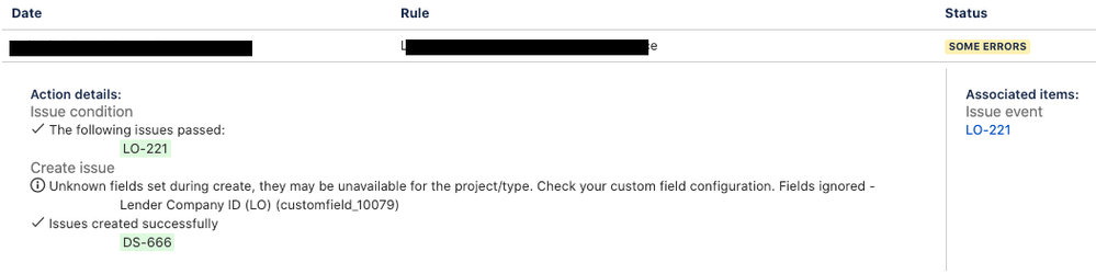

Here's the outcome/audit trail results as well

Thanks for all the screenshots and the description here.  I can see what you are trying to do here.  I understand that you are trying to use automation in Jira Cloud in order to create a new issue in another project and in the process copy/sync a custom field value from the source issue into this destination issue.
If either one of these issues is in a next-gen project (and the screenshots certainly make it look like these are) that will be the problem here.  Next-gen projects do custom fields in a considerably different way than the classic Jira projects do.  More details in Customize an issue's fields in next-gen projects and from that page:
Fields in next-gen projects are contained within the project itself. Currently, you can't share a field created in one next-gen project with another next-gen project, or with a classic project. Similarly, you can't use a custom field created in a classic project on your next-gen project issues.
The only way I would expect this to work is if both projects are classic projects. If either or both projects are next-gen projects, then I don't know of a clear way to make this work the way you want in those project types.  Certainly if both projects classic type, then when a custom field is created, it can be a global custom field (or the custom field can be setup to have the same context for both projects).  This way both projects can see what values are valid for that custom field and then it becomes possible.

Ok, so I had to play with this a bit to get it working, but yes, it is possible to get these values over to another issue using automation's smart values.  The problem here is that because these are project rules, the list of available fields is limited to fields in that original project.  So we can't directly select the destination field here.
However we can use the advanced fields to do this, we just need to make sure that we get the json payload correct when doing this.  In my own example, Project #1 has a custom field of text type called "ShortText1" while the destination project has a different custom field with the name of "shortertext".  In this example
"fields": {
"shortertext": "{{issue.ShortText1}}"
When using this more options section of the automation action, there are additional fields that can be defined this way.
Try this, I got it working in my own Cloud site using automation. Both projects are next-gen in my testing.  Let me know if you run into any problems with this.
