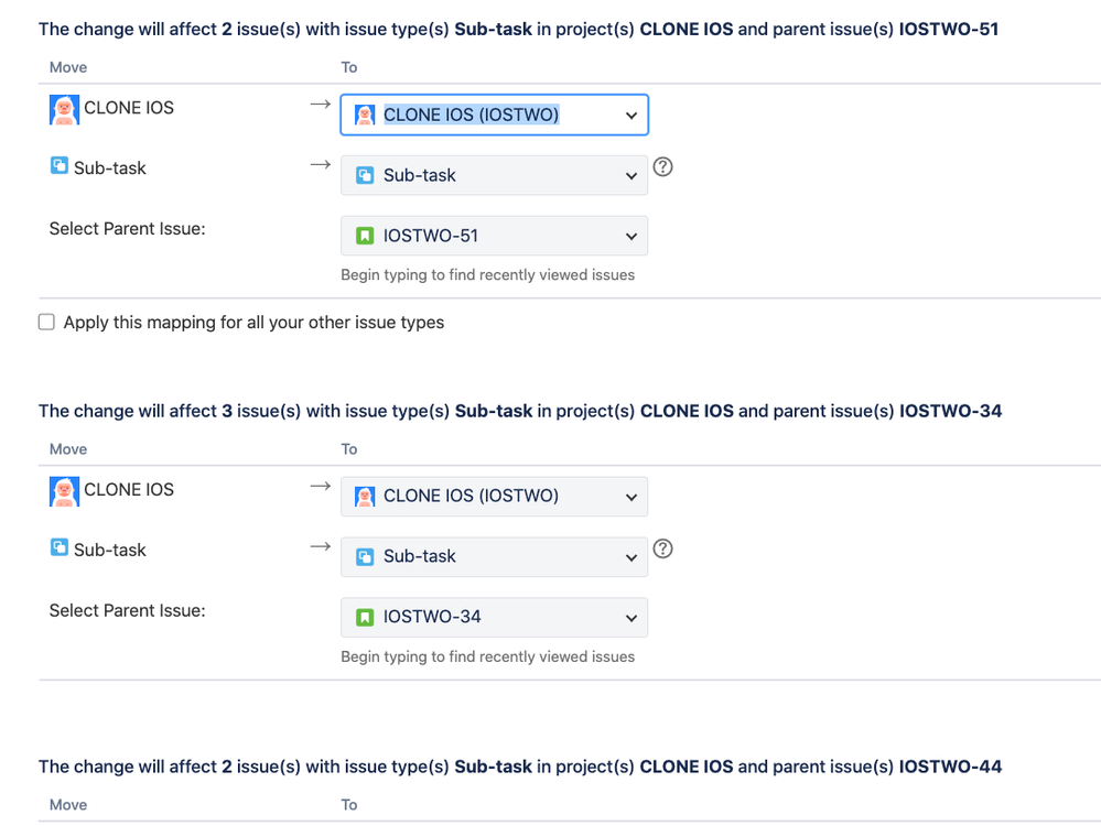

Hi @Danielle Green
If you perform bulk edit and select move then you will get an option to keep or change the parent issue. Check the screenshot below.
It will be a bit challenging to do it for thousands of issues. May be break it up in batches from issue navigator.
