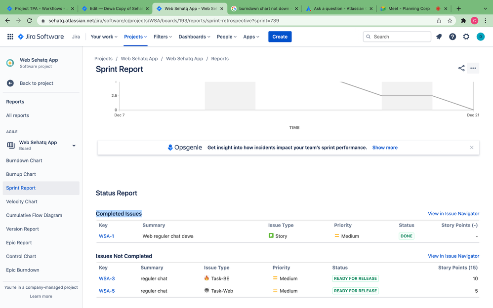

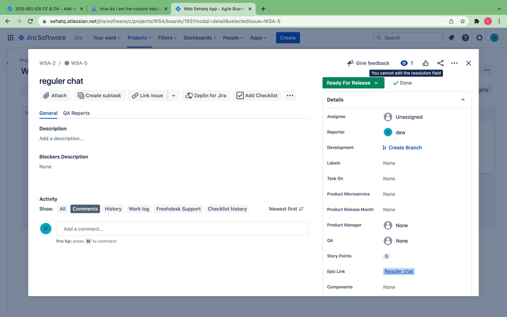

×Actual: i create custom status, which is "READY FOR RELEASE" (green status, and i've set resolution = DONE)
but when i drag my card to ready for release, burn down chart not burning down, or jira didn't recognize those tasks is completed issues

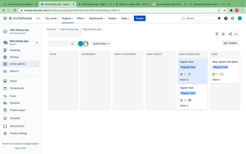

Expectation: i need if i drag my card to "READY FOR RELEASE", the burn down chart will burn down, and jira recognize those tasks are a completed issues.
guys, is there any tips for that? i need tasks that have status ready for release, it makes burn down

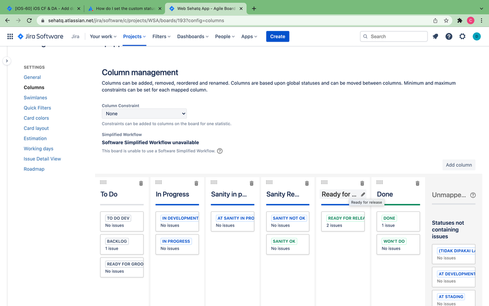

1. here the coloumn attached
2.here the evidence = resoution done
3. My active sprint board looks like this:

For an issue to be seen as 'Done' in a sprint, the status that the issues are in must be mapped to the right-most column of the Sprint board. I would check the config of your board to make sure that the Ready for Release status is mapped to this column
Hi @dew

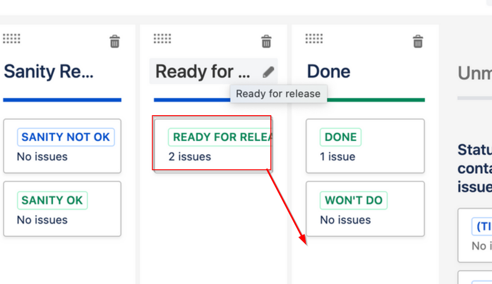

The burndown chart will only think that issues in Ready for Release are completed if this status is mapped to the final (green) column of your board.
So you will need to map this status to the column next to it (and then you can remove this empty column)

@dew Unfortunately not no, the final column is what Jira uses to mark the tasks as 'Done' and therefore edits the burndown chart.
One suggestion is that you could only have the Ready for Release (and maybe Won't Do) status on the final column of the board, and then you could create a separate Kanban board within your project with two columns - one as Ready for Release and the second as Done, and this board could be used to track the releasing of issues?
I have this same issue except I do have all green / "Done" statusCategory types in the right most column and yet still my Sprint Report doesn't count them as completed. What am I missing? This is pretty frustrating... Thanks in advance.
