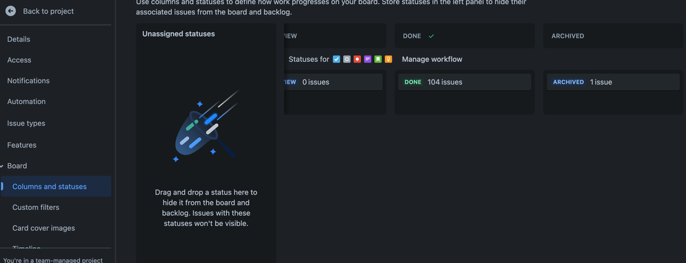

Chaya Adams February 1, 2024 edited
I too would like to have the board either show my sub-tasks (stories) or be able to search and OR add a filter for reporter OR assignee.
I can't see an option to change this in project settings or the the burger...
Thanks in advance for any support.
Board Type.png Sub-task.png Project settings.png Card Cover.png Board options.png
Nic Brough -Adaptavist-
February 1, 2024
Welcome to the Atlassian Community!
Your screenshots look like your project is a team-managed project.  The board for a TMP is fixed to a filter that is just "this project", but there are some configuration options for the board.
Go back to the board, and look for "manage custom filters" in the burger menu
You should be able to add many filters in there.
For sub-tasks, I'm quite fond of "issuetype in subtaskissuetypes()" and "issuetype in standardissuetypes()", and for your users, although I don't know which users you are looking for, "assignee = currentUser() or reporter = currentUser()" might be a good starting point.
The filters you add will appear in the "custom filters" dropdown.
Like Chaya Adams likes this
