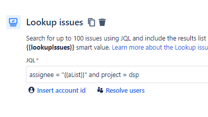

However, after trial an error I came up with a solution, which may cost you on performance. But we'll get to that! So this is my rule:
The magic component is lookupIssues. This is where you should narrow down your search and try to have as less results as possible.
And then when you create your issue, you simply write the following to the summary:
I've tested it and works like a charm!
