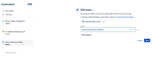

  1. Instruct your team to add a specific label for each board you have, so you will be able to select its active Sprint. E.g: Label "Scrum" for the active sprint in the "Scrum board":
