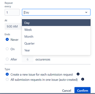

My team has developed Forms & Checklists for Jira and BPM. And we have one more solution that helps to automate checklist creation.
Try out the Recurring Checklists and Report add-on.
It allows adding checklists:
Learn more in our documentation!
Use free 30-day trial period
