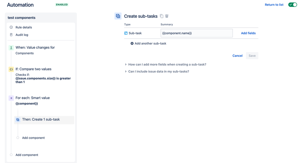

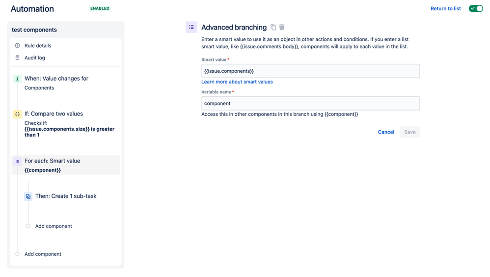

I am not sure what your exact use case is, but I think you could achieve your goal with the following automation rule:
This rule gets triggered if a new component has been added to an issue. Then, it checks if there is more than one component set on the issue. If so, it creates a new sub-task for every component assigned, where the name of the sub-task is the name of the component.

Just a question on the above,, If Someone were to set up an Issue or Story with multiple components initially would the subtasks be created from that first creation?
As opposed to the Issue / Story being set up with one component  originally and then once a new component is added the rule being triggered...
I definitely have plenty to work with in your response so thanks again for that! :)
Michel Neeser
May 18, 2023
@Miriam Callahan
Yes, because the trigger "Value changes for" fires for newly created issues as well.

Tushar February 12, 2025
Hi ,
The automation rules works for creating subtasks for components, but it should create subtask summary for each component. The result is showing subtask summary as "combined component" names.
Story A is having component A, B and C
Current automation rule result as:
Subtask 1 with summary - ABC
Subtask 2 with summary - ABC
Subtask 3 with summary - ABC
Expected result should be like:
Subtask 2 with summary - B
Subtask 3 with summary - C
