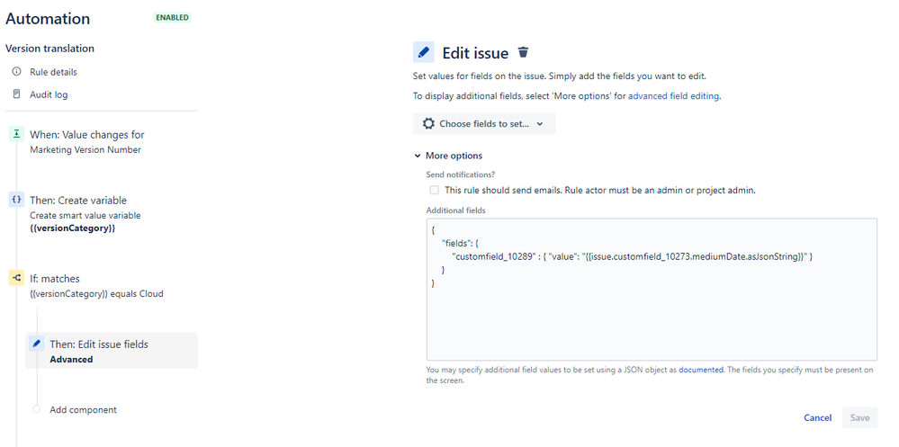

I am trying to copy a date field value into a string field in automation. I was thinking I'd have the best luck using smart values.
customfield_10273 is a date field and customfield_10289 is a string field. I am trying to copy the date in 10273 into 10289 as a string.
I have tried:
{{issue.customfield_10273.value}}
{{issue.customfield_10273}}
"fields": {
"customfield_10289" : { "value": "{{issue.customfield_10273.value.asJsonString}}" }
Does anyone have any experience or suggestions for this?

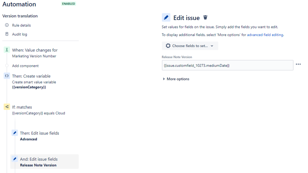

So the screenshots here were just to show you all of the different ways I've tried to edit this field (advanced JSON and the normal "Edit Issue" action).
I have been testing all of these scenarios individually, never together so there's no overwriting going on.
This is the error I get when I try to edit the field with advanced editing: "RN-18 (Operation value must be a string (customfield_10289))"advanced error.PNG

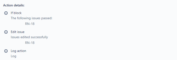

And what it looks like when I try it with the normal "edit issue" action. Here it says success, but nothing is actually getting added to the field:
Again, I believe this is all happening because a date and a string are different types, and I need to figure out the syntax to translate the date into a string (if there is any).

Update: I was trying to do this with a hidden field (a field not on the screen)- turns out you can't do that. I got it working using the normal "Edit issue" action with "{{issue.customfield_10273.mediumDate}}" and put the field on the screen
