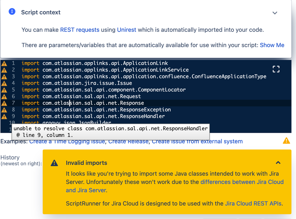

I am using Jira Cloud and Confluence Cloud
I found examples for creating Confluence Page from a Jira Server using ScriptRunner.
https://scriptrunner.adaptavist.com/6.17.0/jira/interacting-with-confluence-from-jira.html
But most of the libraries in the example are not available for the Cloud version. For eg `com.atlassian.applinks.api`. I am not able to use application links to authenticate Jira to Confluence. Can someone shed some light?
Hi Jibu,
I can confirm that the example you have linked to will not work as this for Jira Server and the APi's are different between the Cloud and Server versions of ScriptRunner, due to the fact Atlassian only provides a Rest API in Jira Cloud and not a Java API like the sever version contains.
This means for ScriptRunner for Jira Cloud you should always refer to its own documentation located here and sI can confirm that we have an example script located in the documentation page here which can be run from the Script Console inside of ScriptRunner for Jira Cloud.
Using this script you will be able to see how to create a Confluence page and you can use this script as a reference guide to help you to create the scripts that you require.
Kristian
