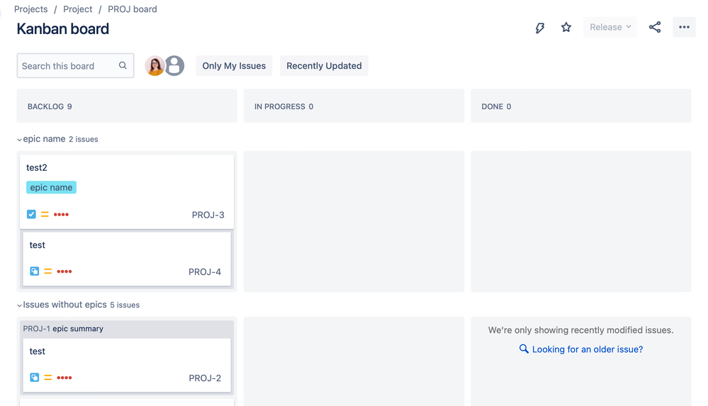

Hey, yes i set the swimlane on Story but the shown swimlanes but the shown swimlane is not based on a story.. do you have any idea on how i can fix that?swimlane2.jpg
That is how my (test)project structure looks like:
Marta Woźniak-Semeniuk
December 12, 2022
Are the story also added to the sprint ?
