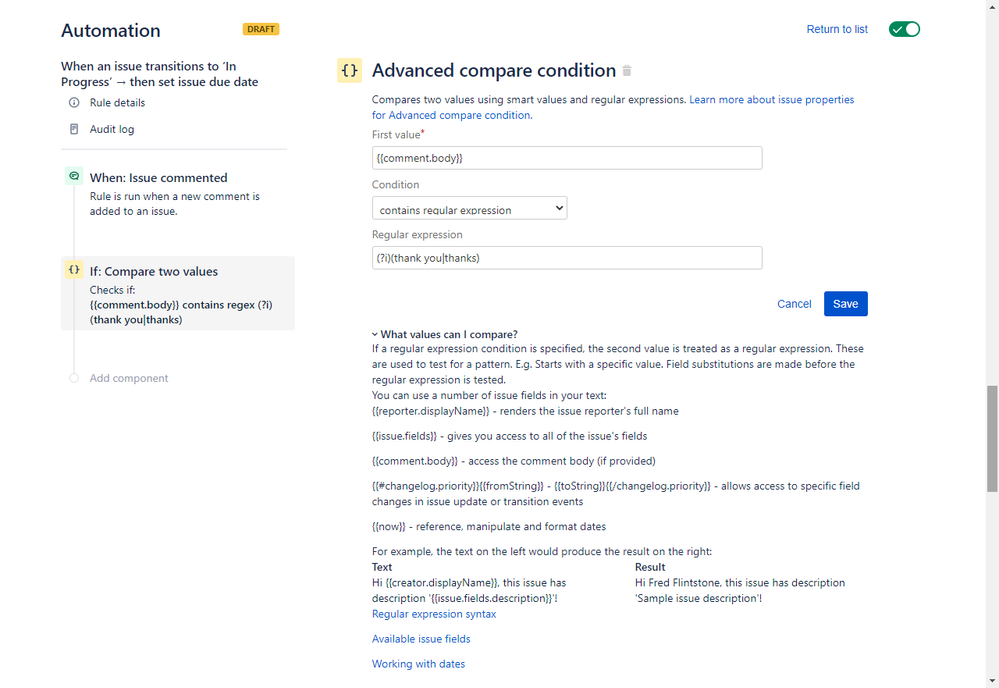

Hi @Alex F ! Tell me if you can create a condition that will track the comment for the words "thank you". For example, if the comment begins with "Thank you". Or it only consists of "thank you".
Thanks))

Hi @Petr AST! I believe you should use something like this:
