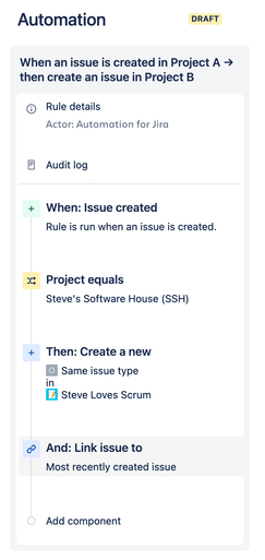

Yes, it is absolutely possible to create a linked issue via automation and then sync status updates across linked issues in different projects. You need a global automation rule for that and that needs to be set up by a Jira administrator in your instance (see this support article on permissions for more details)
To properly create a linked issue via automation, you can use a rule like this (sample from the template library):
To sync the status between issues, you can set up a global automation rule that does the following:
Trigger: issue transitioned
Condition: project = "Project A"
Branch: linked issues -> Action: transition issue
Hope this helps!
