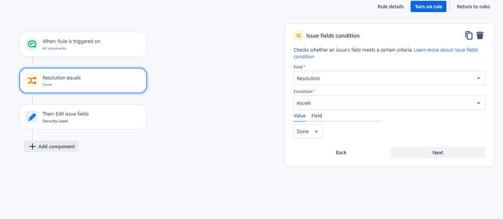

Ezgi Bayındır
November 17, 2023
You can use Automation for set issue security and add condition for that specific fields option. You can look this similar example
