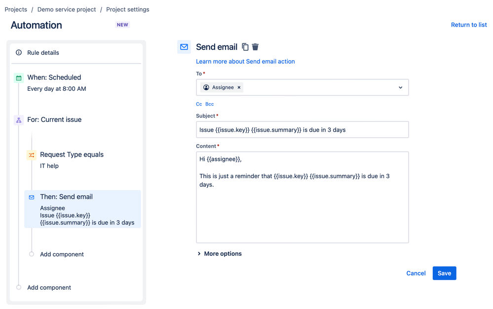

In that case you will need two automations:
The trigger that you need for this is "scheduled" and then configure it to check for issues that are due in three days. My example is scheduled for every day at 8am:
The JQL I used in my example is Resolution = unresolved AND due >= startOfDay(3) AND due <= endOfDay(3).
Then you can configure the email that is sent. In my example I'm sending a reminder to the assignee that their issue is due in three days, but depending on your use case it may be something else. You can use smart values to insert information from the issue in the email.
Note: I've put the conditions after the branch rule. That way you could potentially set up multiple different reminders in the same automation. For example one for issue type A, and a different one for issue type B. But you can also make the rule specific to only one use case, whichever you prefer.
Depending in your volume of tickets this may end up sending a lot of emails, so make sure to test thoroughly!
