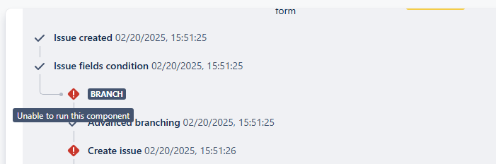

I am using branching and smart values, but the branch rule is not getting executed. Error: Unable to run this component
rule1.png rule2.png rule3.png Could someone help me identify what's wrong and suggest the correct smart values or rule structure?

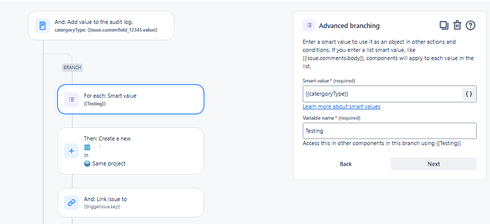

Starting with the original rule you show in the question, when you created the variable, that leads to a text value such as this:
Option A, Option B, Option C
Where using {{issue.customfiled_12663.value}} automatically added a comma-space delimiter.
To then use that to feed the Advanced Branch, the values must be split back into a list:
{{categoryType.split(", ")}}
https://support.atlassian.com/cloud-automation/docs/jira-smart-values-text-fields/#split-String-separator-
As an alternative, you could use the smart value directly to feed the branch:
The values in the branch will be the text of the options selected for the field.

Made an example

February 20, 2025
I made an example, attached images above. I think, it's your case, and it will solve your problem

I tried implementing the same branching rule as suggested, but I am still encountering the same issue: "Unable to run this component." It seems like the iteration is not working as expected in my case.
Are there any additional steps I should take to ensure the list values are properly processed within the branch?
