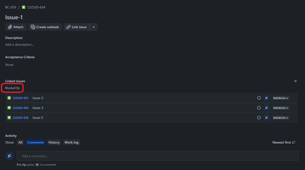

And here it says blocked by but this is the first issue which should be blocking 2, 3 and 4 but its imported it the wrond way around. This should say Blocks.

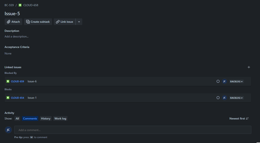

Issue-5 is another example where it clearly shows this is the wrong way around

This is how it currently works - see this help page:
When importing the issue link via CSV, Jira will consider the link you provide as the Outward link description. You can't choose between Inward or Outward links.
