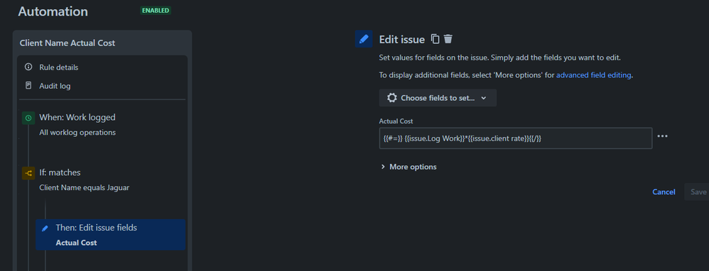

Goal: When a user Logs Time on a ticket, that time should be multiplied by the client rate to give me a value of Actual cost (another custom field that we have)
So for example
Client Rate: 1500
Time logged = 30m
Actual cost = 750
I'm having issues achieving this with the automation, I keep getting errors.

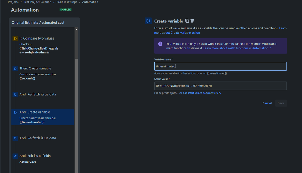

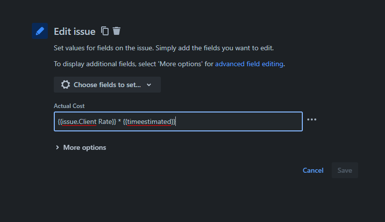

If I may pick your brain once more. I was trying to replicate the same behavior but now to calculate the "estimated cost" based on the Original estimate field. So based on the previous automation I did the followingScreenshot 2023-08-01 144341.png Screenshot 2023-08-01 144404.png Screenshot 2023-08-01 144407.png
However after running it I got this error.
I was able to trigger it successfully but it seems I messed up the "timeestimated" variable.
It's my first time dealing with creating variables so I apologize.
Thank you again
Esteban Halabi
August 1, 2023
I figured out my mistake! disregard! fixed now!
