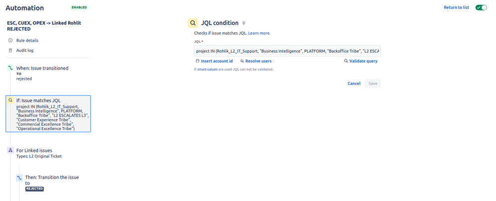

Im having troubles with my automation rule.
Here i want to close the linked issues with a specific linking to a status DONE. Thats working, all good. But i have problem with the "no actions performed" Because the rule was run bu nothing happend but the opearation executions are still deducted and i want to avoid this to not loose our operations execution because of that.
I was reading some other articles and people recommended to add a JQL condition, but im afraid this is not gonna help and it will be the same result.
Do you have any ide what i should set to not loose the operations when the ticket was DONE but not for the specific link?

Correct, it will fire every time an issue is moved to done. The only ways around that are to do either a Scheduled trigger and only run it once a day or a couple of times a day. Or you can set a value of a custom field in a post function on the workflow when it applies, and then change your automation trigger to fire when the value of that custom field is changed.

You could copy the rule and have it be a set of single project rules - that would be a fast fix. But if you need to update the rule, you'll have to do it 8 time, or update one and copy it again to 8 new rules and delete the old ones.
Or you can go the route above where you set a custom value in a transition post function.

Oh, no the first suggestion about having multiple single project rules would not work.
But the second one should work where you use the post function and set the value of a custom field. (the field can be hidden from the screen).
