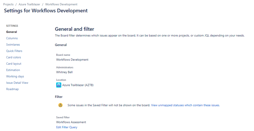

@Whitney Bell thank you for screenshots.
You need to edit your issue source (1st screenshot)
Choose Board instead of Filter in first drop-down and choose Board name Workflows Development in next drop-down to it.
Whitney Bell September 22, 2021
Oh my that worked, wow makes perfect sense now that I think about it! THANK YOU so much!!
Yes they are the same source- here is a screenshot of the filter being used on the plan page:
And here is that same filter being used by the board:
Also, here is the filters page where you can see there is only one by that name:
