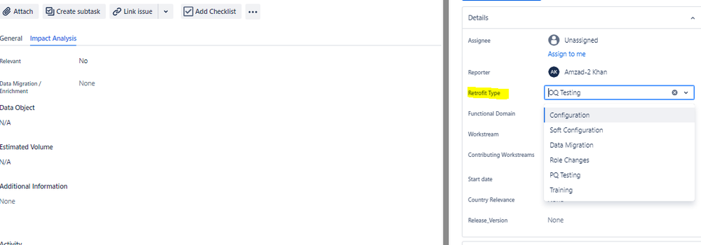

Amzad Khan May 22, 2024 edited
I am trying to achieve the same by using Feild required validator, but I am having different scenario
I am having Field Retrofit with the values as in the below screenshot.
Now I want to add condition in the Transition to "Impact Assessment" to "In Progress" with the below conditions
If Retrofit Type = Configuration then Field Relevant should not be blank
if Retrofit Type = Data Migration then Feild Data Migration Enhancement should not be blank
if Field Relevant is blank when Retrofit Type = Data Migration it should transition to next status In Progress, how can I achieve this?
Is this can be achieved via automation
Maciej Dudziak _Forgappify_
May 22, 2024
Hi @Amzad Khan
I am not sure about Automation, but it will be quite simple using any Jira expression-based validator/condition available on the Atlassian marketplace.
I am from Forgappify, and we developed Jira Expression Validator/Condition, which is part of the Workflow Building Blocks for Jira app.
The expression you need would be similar to the one below:
issue.customfield_a?.value == "Configuration"
? issue.customfield_b != null
: issue.customfield_a?.value == "Data Migration"
? issue.customfield_c != null
: true
where customfield_a represents Retrofit Type, customfield_b is Relevant field, customfield_c is Data Migration Enhancement.
You need to change customfield_ids to match ids on your instance. With our editor it is easy, just start typing the name of the field after "issue." , and you will get the correct suggestion.
I hope this is helpful for you, regards!
