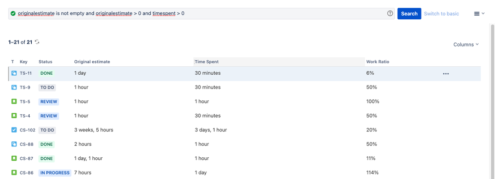

I want to compare the original estimate and time-tracking data for issues that are in a sprint. So, I can evaluate if estimation time guesses failed or were successful and how is the failure rate for a sprint is.

The Work Ratio field will show what percentage of the Original Estimate has been consumed by time logged. You can see the information in the Advanced Issue Search screen when you use List View and add the Work Ratio column. A Work Ratio over 100% indicates more time was logged than in the Original Estimate.
