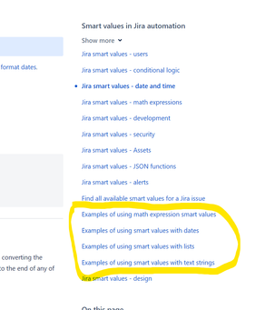

For me it was experimentation and repeatedly reading the docs. That toDate function can be found here: https://support.atlassian.com/cloud-automation/docs/examples-of-using-smart-values-with-dates/#Converting-text-to-dates
Longer answer:
The original Code Barrel blog had lots of info, but that is gone now that the product was acquired by Atlassian. The current documentation has improved over time, but still has a challenge that many things are not where you would expect them to be, and some of the examples have typos.
Many of the very helpful things are quite well hidden in the examples sections, like these:
Plus there are links out to the "based upon..." tools, like regular expressions from Java Pattern class for the match() function. I recommend jumping out to those when you see them, and then creating a test rule to learn if A4J actually works that way. Spoiler: the regex appears to be different when used for match().
