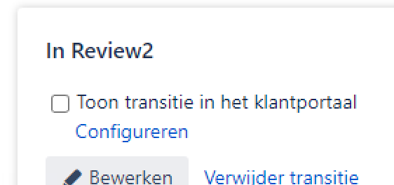

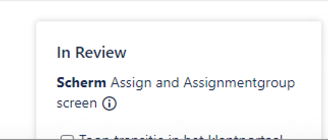

Regarding your situation, I have tried to recreate the situation on a Server environment. When I rename the transition, the popup screen of the transition is then shown without mentioning the transition screen.
But if I publish the change immediately, the transition screen appears to be properly linked.
Are there adjustments be made to conditions or validators after changing the name?
Regards, Marco
P.S. Hereby 3 screenshots of the name change of transition from In Review to In Review2 (my. Jira is set to Dutch language)
