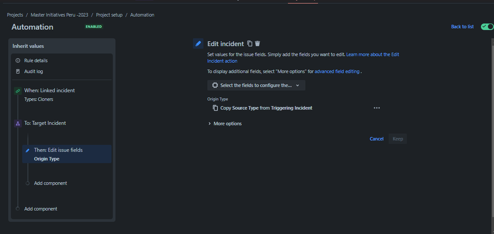

Leonardo Zevallos Guzman
November 22, 2023
In which part do I order the Project B incident to copy the data from the Project A field. When I link From Project A to Project B. I couldn't understand what he told me
Ste Wright
November 22, 2023
Hi @Leonardo Zevallos Guzman
Click on the box "Copy Source Type from Current Incident"
A pop-up will appear, and you want to choose to copy the data from the Destination Incident.
Ste
November 22, 2023
The rule causes the value to be changed in the Project A issue. The objective is to change the incidence of Project B.
Because from an incident of Project A I link to an incident of Project B.

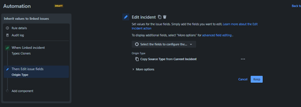

Ste Wright
November 22, 2023
I'd give the opposite direction a try (destination issue), and see if that works - the rule would look like this:
  • Trigger: Issue Linked
    • Link Type = Cloners
  • Branch: Related Issues
    • Type = Destination Issue
      • Branch-Action: Edit Issue
        • Field = Field Here
          • Value = COPY FROM
            • Issue to copy from = Trigger Issue
            • Field to copy from = Field Here
Ste
November 22, 2023
The rule doesn't change anything.
I have configured it like this:

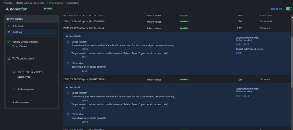

Ste Wright
November 22, 2023
In either scenario, what does the audit log state?
Ste
November 22, 2023
Hello! It's strange because before the audit came out like this and now it works correctly. In Jira does it take to update when an issue is edited?.The thing is that it already works, thank you dear @Ste Wright
Ste Wright
November 22, 2023
Time to complete can vary (depending on how complex the rule is), but it can be often 5-10 seconds.
Great to hear it works though!
