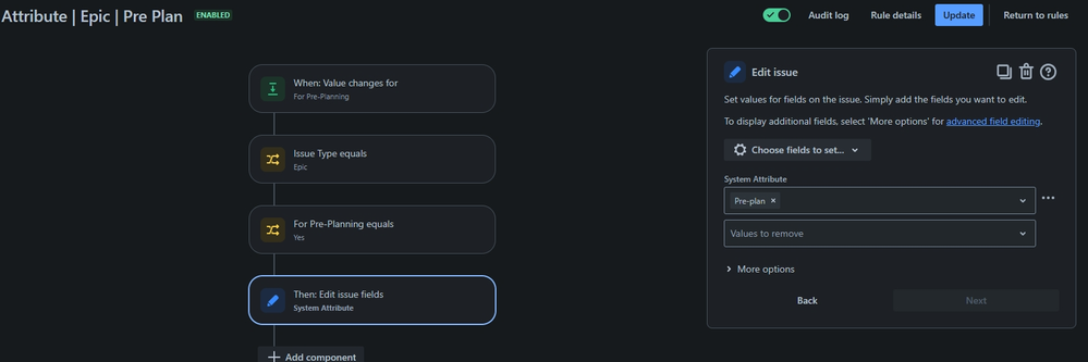

I'm working on this automation but I don't know how to set a required field before moving another set value
here is the condition:
"For Pre-Planning": Yes -> system attribute: pre-plan | PM to plan on tempo, "Client Quote Approval Due Time" becomes a required* field before the PM can set the "For Pre-Planning" field to Done planning.
Please see below my current automation.
Matt Parks
April 11, 2024
I'll let others who are more familiar with Automation than I am confirm, but, I'm not sure that it's possible to require that someone edit a field in the middle of an automation rule.
If you have Scriptrunner, you could set up a behavior that would make a second field required based on the value of another field which will dynamically update on the Edit/Create/Transition screen when the first field's value is changed.
