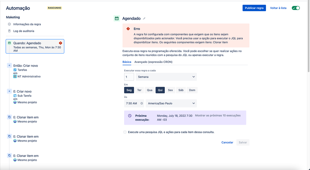

I am trying to create an automation that creates 7 equals issues every week at 7:30 monday. but keeps giving me this error when i set the schedule:
The rule has been configured with components that require issues to be provided by the trigger. You need to use the option to run JQL to provide issues. The following components require issues: Clone issue

Hi @Bruna Junckes Sant Anna
That error is indicating your rule actions are referencing issues and fields, but the trigger did not supply any issues.
The fix depends upon what you want to do:
  1. if you are creating new issues independent of other data, check the actions to remove an field references and smart values
  2. if you are creating new issues based on other issues, your trigger needs a JQL statement to select an issue first
Which of those matches your case?

What we can see in your rule image is this:
  1. trigger is scheduled (with no JQL)
  2. create a task
  3. create a sub-task for that issue
  4. create another task
  5. create another task
  6. create another task
In this case, only the sub-task from step #3 has a parent: the task created in step #2.  If you want the others to have the same "parent", they must also be sub-tasks and not tasks.
If I am misunderstanding your need, would you please try explaining further?  Thank you!
  2. create a task
  4. clone the sub-task before with all informations also with the same parent link the task, the one created at item 2
  5. clone the sub-task before with all informations also with the same parent link the task, the one created at item 2
  6. clone the sub-task before with all informations also with the same parent link the task, the one created at item 2
  7. ...

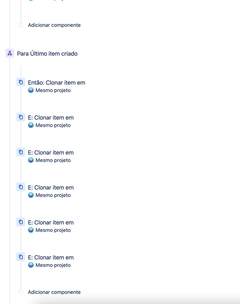

Does not work, creates the subtask, but when clone issue makes the clone a task and not a subtask
July 18, 2022
Would you please post images of:
  • your complete current rule,
  • the details of the clone action, and
  • of the audit log details showing an execution.
Seeing those may provide some context for what is happening.  Thanks!

Captura de Tela 2022-07-20 às 09.44.03.png Captura de Tela 2022-07-20 às 09.41.42.png
July 20, 2022
Thanks, that helps explain things!
The Clone Issue action works on whatever the "current" issue is in a rule, and that can change based on rule components, such as where you are in the rule's steps.
When you wanted to create the first subtask you branched to the parent task.  Afterwards you can branch to the subtask and then clone...like this.
  • trigger: scheduled
  • action: create task
  • branch: to the most recently created issue (i.e. the task)
    • action: add a subtask
  • branch: to the most recently created issue (i.e. the subtask just created)
    • action: clone (which uses the subtask as source)
