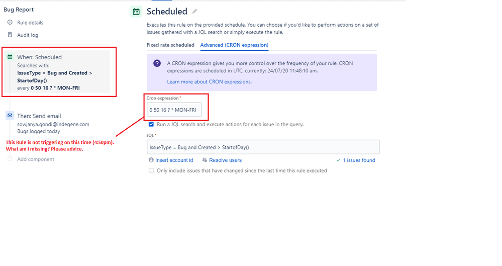

I am trying a simple rule with CRON expression. To send an email at a certain time everyday as a result of JQL condition. The first check is to verify if the rule runs on that time specified in the CRON expression. This is failing. Rule is not being triggered.
I am attaching the screenshot of the Rule. Can someone please take a look and let me know what I am missing?Untitled.png

so be sure to use UTC for your cron expression. so if you are in say EST and want to trigger at 2pm every weekday that would be 0 0 18 ? * MON-FRI

Thanks so much! this works
