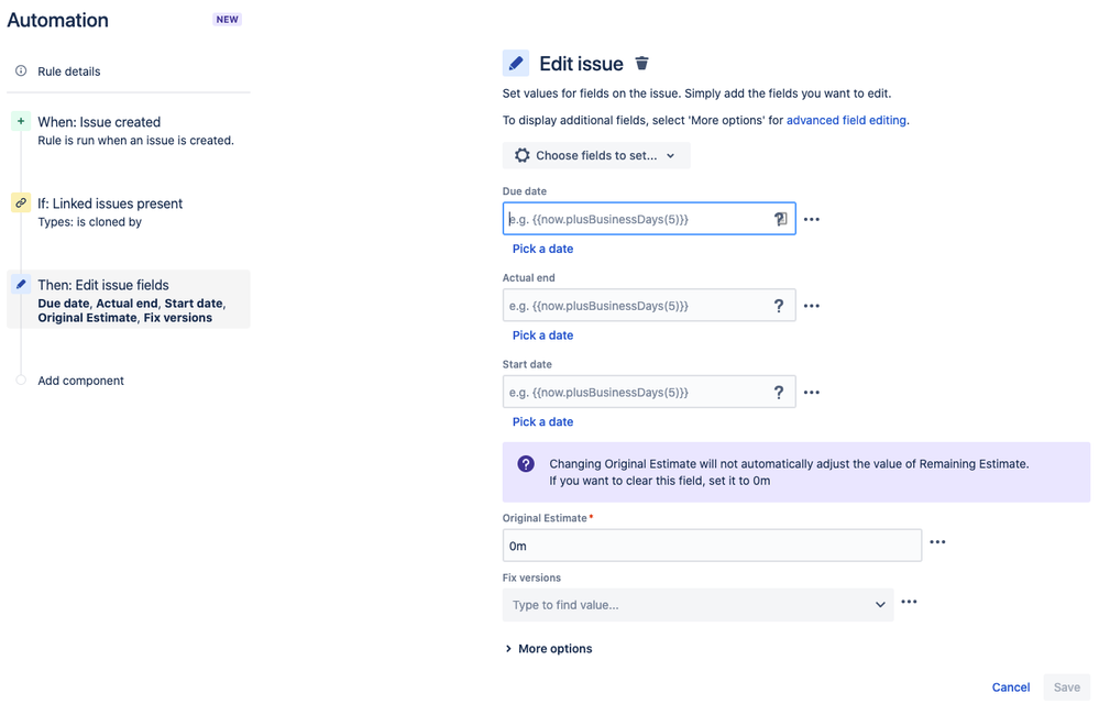

@Prabhu Chilukuri - You can accomplish this with automation.  You can either recreate the clone process altogether with the desired fields copied over or create a rule that updates after the issue has been created:
  • TRIGGER - Issue Created
  • CONDITION (If applicable) - Whatever delineates these issues from other created issues
  • ACTION - Edit Issue: Add all the desired fields and simply leave them blank. The rule will clear them out.

I am new to Automation rules. Could you please provide me the Example Automation rules for the above scenario?
Prabhu Ch
Mark Segall
February 18, 2022
Hi @Prabhu Chilukuri . Here's an example of how it could work:
