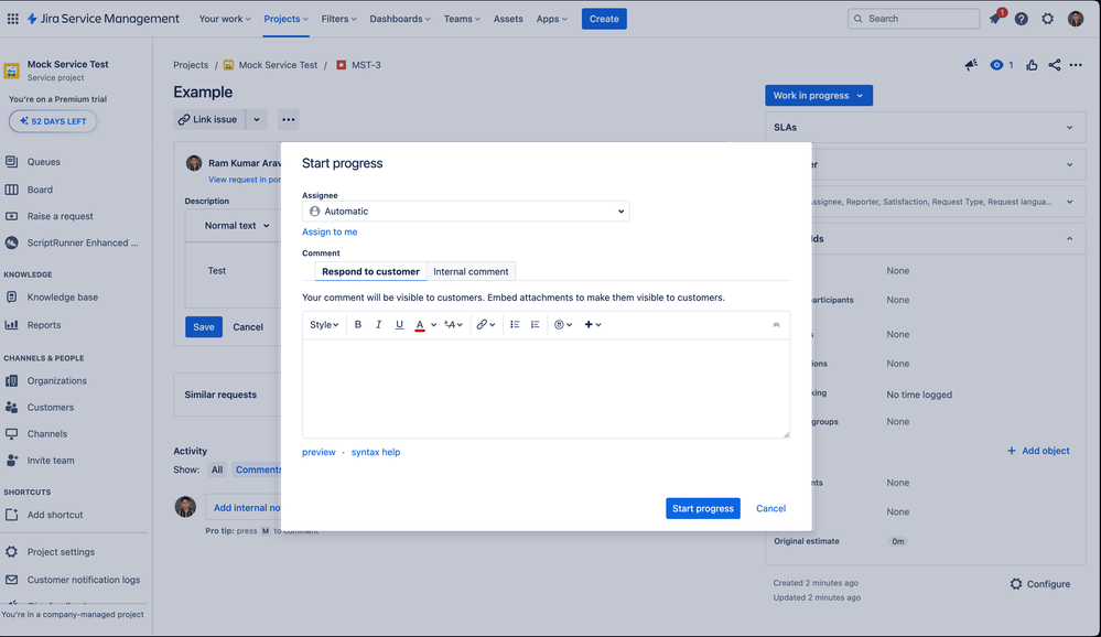

4. If there is any transition screen, set the values accordingly. The screenshot below includes only the Assignee and  Comment fields in the transition screen.test4.png
