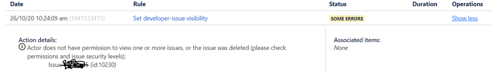

I'm trying to create an automation rule to assign a particular level of issue-security based on the issue type.
I read the post
https://community.atlassian.com/t5/Jira-Software-questions/Set-Security-level-with-Automation-rule/qaq-p/1420285
I checked that:
- the atlassian-addons-project-access role is configured to be a member of the security level I'm trying to set
- the atlassian-addons-project-access role has all the permissions in my project.
Attached is the log I get when I create the issue an the automatation runs.
undefined
Do you have any suggests? What am I missing?

Hi @Andrea Mazzeschi ,
In Rule Details you can enter an actor. Which user has been specified in your rule? And has it been checked (with permission helper) whether this user have the correct rights?
regards, Marco
Andrea Mazzeschi October 26, 2020
Hi Marco,
thanks for you answer.
The actor is the "Automation for Jira"
image.png I can't check if it has the permission using the permission helper, is not a listed user.
