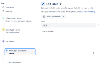

the easiest way would be to add the execution as a sub-execution of the story. In this case you could create the automation rule similar to the previous one:
  • when: issue is created
  • condition: issue type equals sub test execution
  • branch: for parent
  • action: edit issue, field lable, set value "TE"

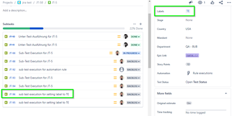

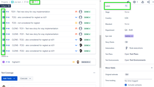

My tests went OK. I tested like follows:
  • given - a User Story with test cases inside
  • when - I generate a sub test execution within the story by clicking "Execute - with Sub Test Execution" in the Test Coverage area of the story
  • then - Sub Test Execution is created as subtask of the story
    • and - Label of story (parent of the Sub Test Execution) is set to TE
(see screenshots)
given
when
then
audit log output

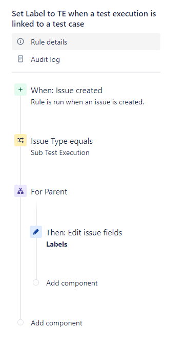

Could you please show a screenshot of your automation rule? And if possible of how and where you created which test execution (everything that would help analyzing)

Is this behaviour reproducable? Did you try this again and it happens all the time? if so please document step by step.
Could you please also provide screenshot from your automation rule?

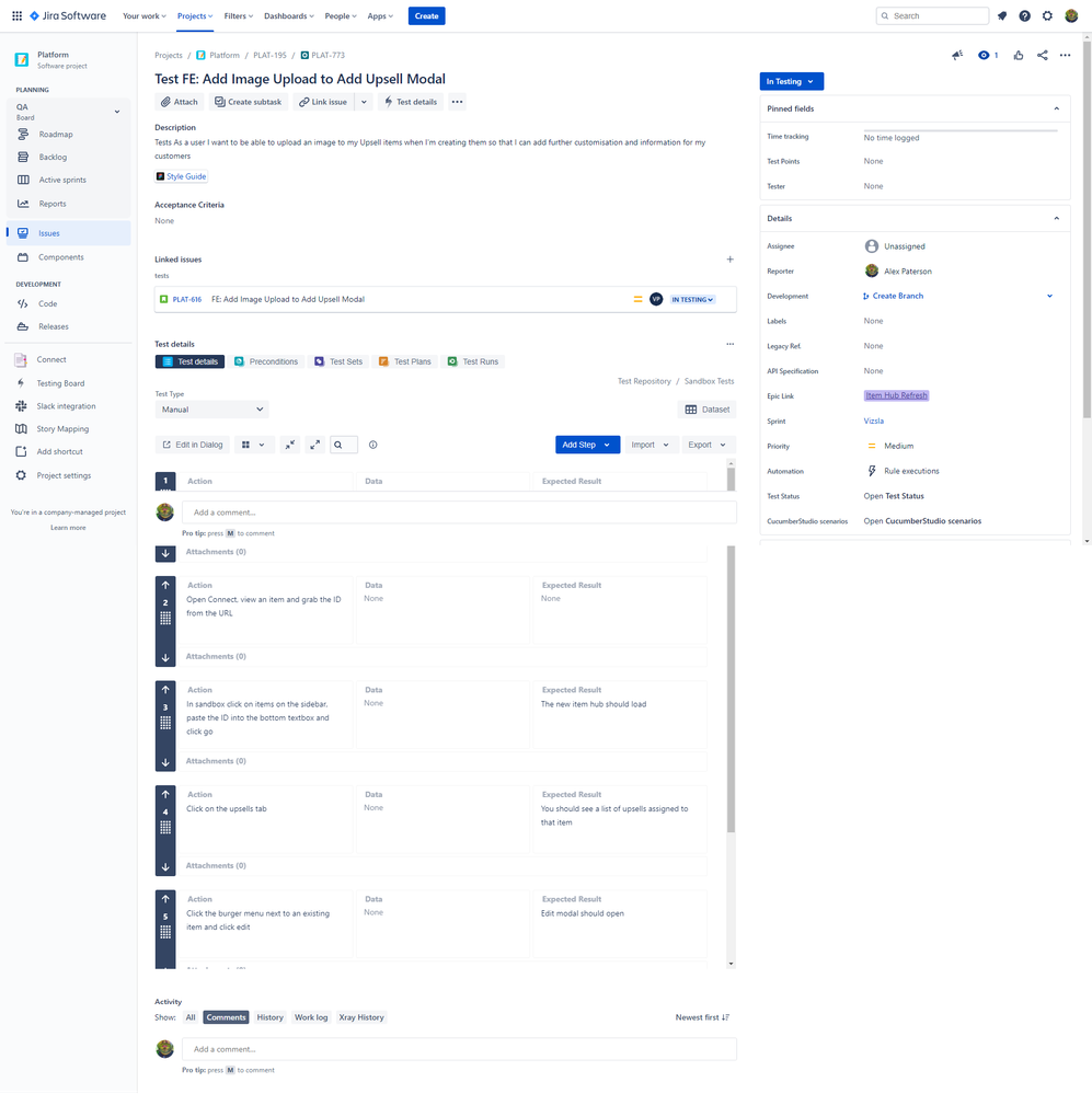

Alex February 23, 2022
The automation works.
616 is the task and 773 is the test.
The images are quite large, I'm not sure if they will work well on here. I may need to upload them somewhere else and post a link to them.
-PLAT-616-FE-Add-Image-Upload-to-Add-Upsell-Modal-Jira.png -PLAT-773-Test-FE-Add-Image-Upload-to-Add-Upsell-Modal-Jira.png
