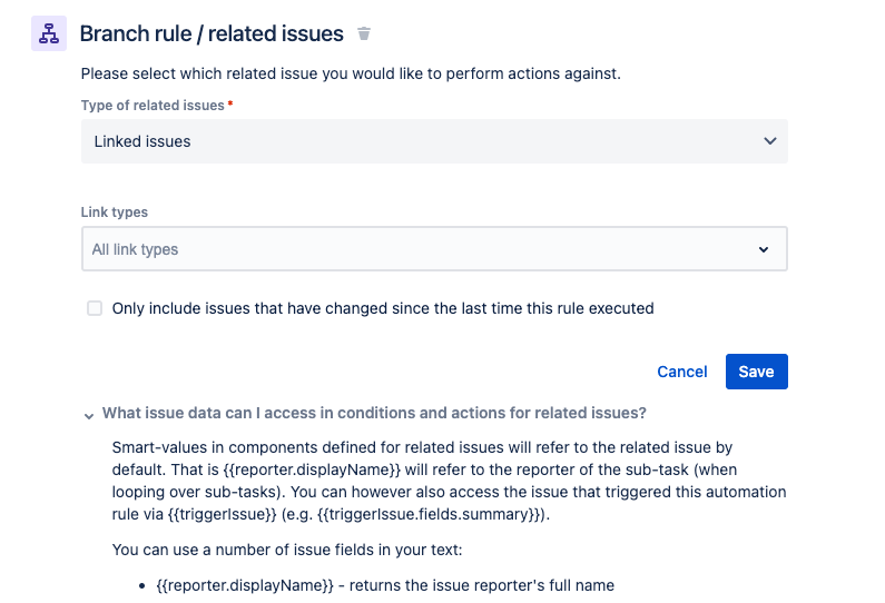

If you use a branch to get the linked issues, then you use {{issue}} to reference the current linked issue within the branch and {{triggerIssues} to reference the issue that triggered the rule.

Yeah sorry, it's an automation, so if I use this branch rule am I able to edit the linked item without making an mult-project rule, or am I just able to use smart values based on the linked itens?

You can edit the items without making a multi-project rule. The multi-project rule setting applies to the triggering of the rule, not the actions that you take in the rule after it has been triggered.
