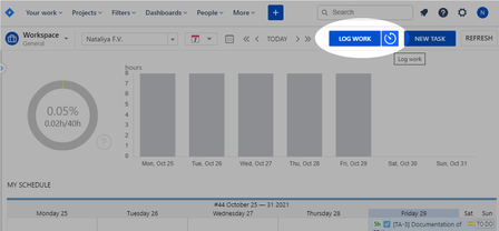

I'm writing on behalf of the ActivityTimeline add-on. Our add-on has a time tracking feature with "Log work" button as well. When click button the timer is started. To stop the time tracking you need to click the same button. Then time is auto filled-in in log time panel.
If you need more details refers to ActivityTimeline page.
