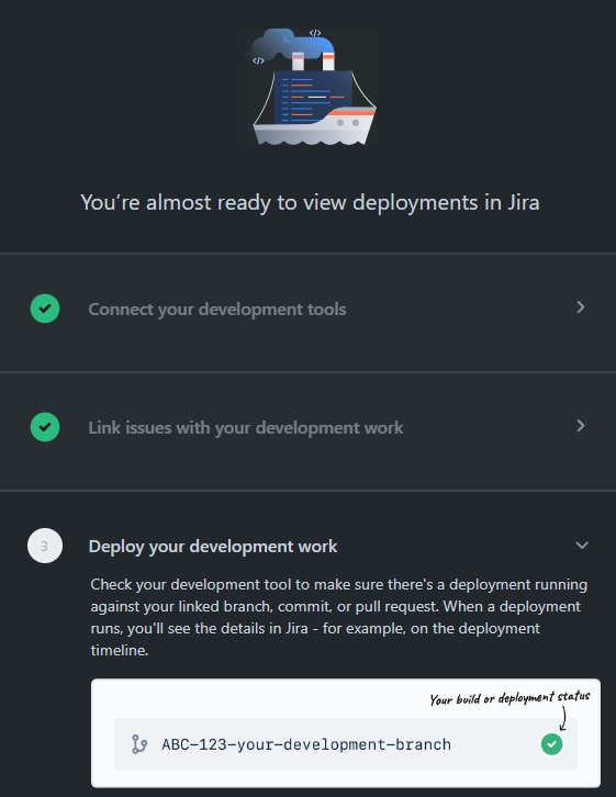

I have been trying to Enable and Configure Deployments Feature in JIRA. The deployment feature is indeed enabled but it is stuck in the following last step:
Also, I will be using Azure DevOps release pipelines to report deployments statuses back to JIRA but I am unable to actually configure this feature in JIRA in the first place.

Hi @Curt Holley thanks for replying.
I have read this documentation but I still am unable to configure this feature properly and stuck on the last step as mentioned in the image above.
I am using Azure Pipelines for deployments and I have also configured my Azure Pipelines for JIRA app but still this feature is not getting enabled for me.
