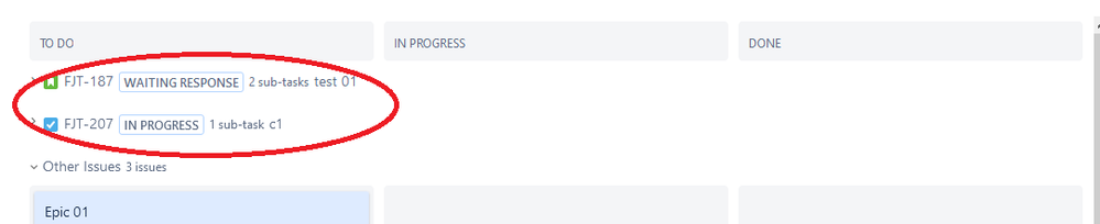

@Callum Carlile _Automation Consultants_  Yes. story points are associated to the screen and it's showing up on the detailed view. It showing up on the cards. we need SP to be displayed for the parent issue (FJT-187)Screenshot (347).png

@Bill Sheboy  Ohh no. Yes, summary is dispayed. I said story points are not getting displayed, that's the reason we choose to update the issue story points to the summary using automation.
