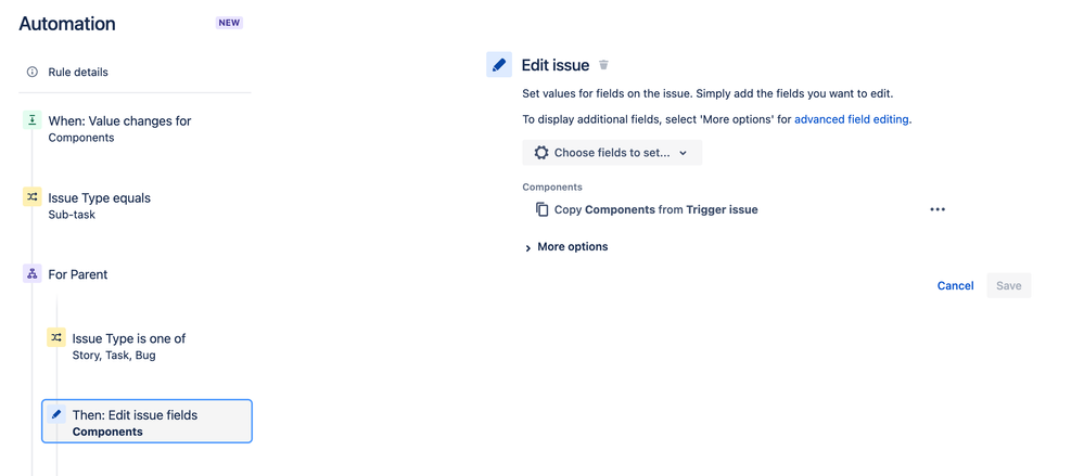

Hi @Joni Johnson,
When working with parent issues etc. you will need to create a branch in your automation rule to determine that you're going to update your linked issues. Inside that branch, you can apply additional conditions.
So just add such a condition to specify what types of parent your issues should be updated. Something like this:
Screenshot 2022-10-17 at 16.44.47.png I don't have an initiative custom field, so I used components instead, but I hope you get the idea.
Hope this helps!

Thank you for sharing and including the image. I tried this yet couldn't figure out how to update the initiative value on the trigger issue (subtask) to the initiative of the parent when the issue type was not an App Release using the For Parent.  I know I will use the For Parent with other rules so appreciate the sharing.
