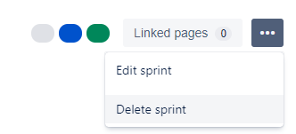

To modify an active sprint end date,
Click edit sprint, you can edit Sprint name, start date, end date and goal.
