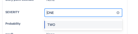

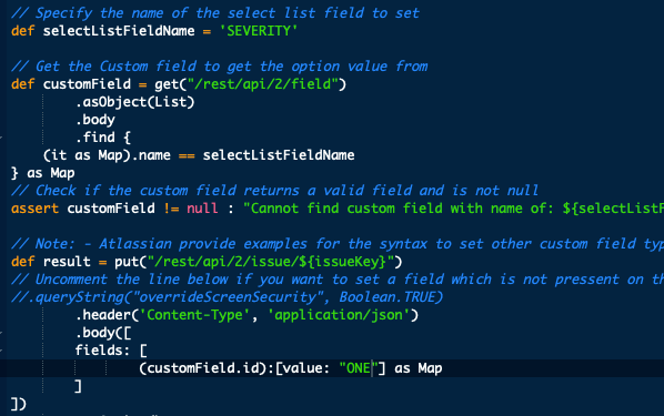

Hi again,
I think you should use the External Severity value , I mean,  Trivial (1), Low (2) ..... For example, I checked with a cf called "Severity" which has two possible values ,  ONE or TWO.  Check my screenshots for clarifying it.
I hope it helps.
Alex Ivanov August 24, 2023
Thanks, this format works!
