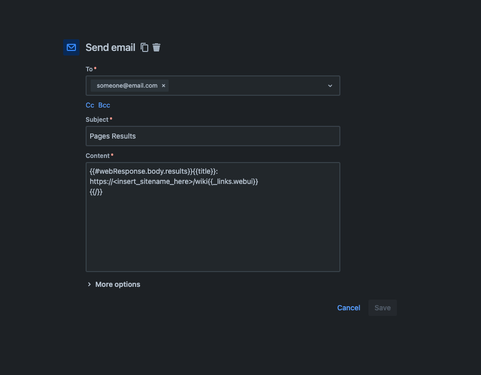

Branches do not support aggregating data for a single action like you are trying to accomplish here. However, @Bill Sheboy is correct that going with a manual web request to the Confluence API could enable you to accomplish your desired outcome.
I used the Search content by CQL endpoint to find pages by CQL query. Then I followed up in the Send email action with the Multi-user picker smart values to use the fields from a list to put together an email body with the page title and page URL. I did need to hard code the base URL value in the email action. I will attach some screenshots that I hope will help.
